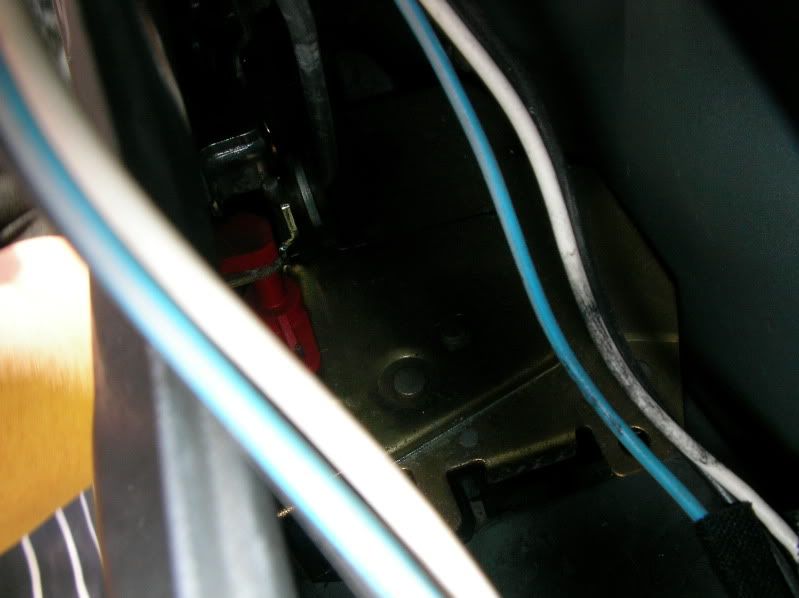

Have finally managed to get the door card off, and can't see up in the rear corner where the handle is. The rod of the inner handle is connected and moves ok, the button is still connected also, just can't see up in the rear corner. So the actuator is part and parcel with the deadlock is it then? So when the doors lock, the deadlocks come on with the motor right? I can see the 3 wires along the bottom of the door, white, blue and black, but again, can't see the motor in the rear corner.

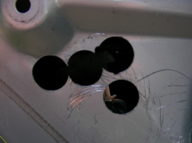

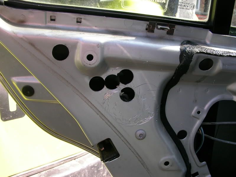

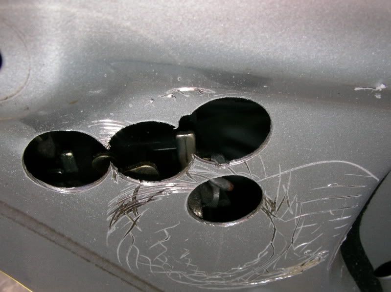

Ok, went to the indy I know and asked him, he said the actuator will be at fault, just gotta rip it out, literally, and the door will be openable, but will have to manually lock/unlock it. COuldn't see up in the corner, so ended up having to drill out some holes carefully, and got an eye view of the actuator, prised it out with flatblade, hey presto, the door unlocked and could open from inside and out. Hurray.

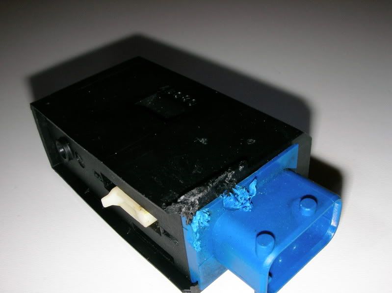

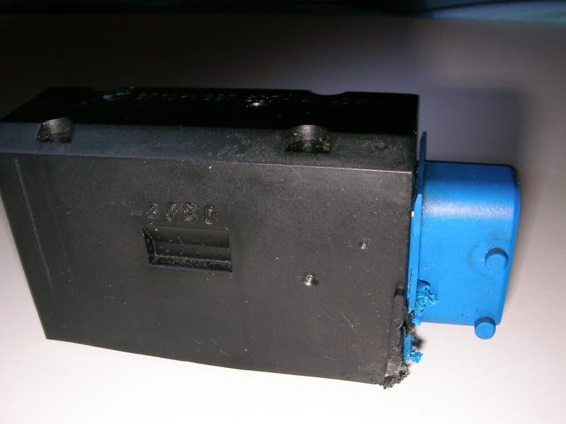

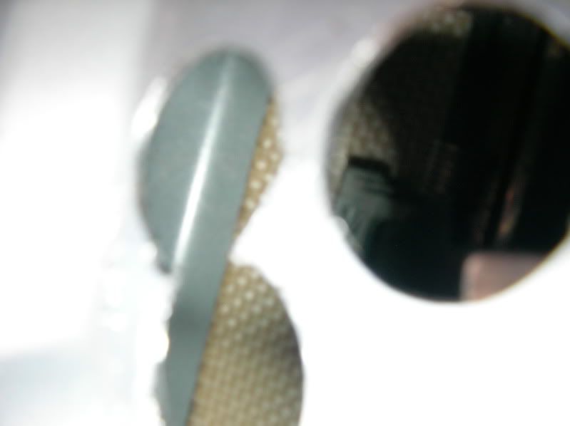

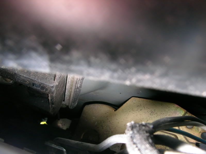

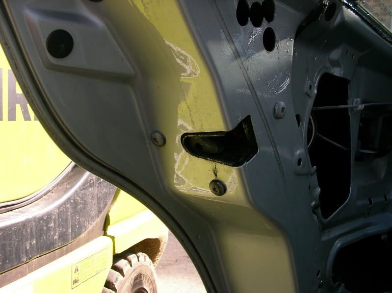

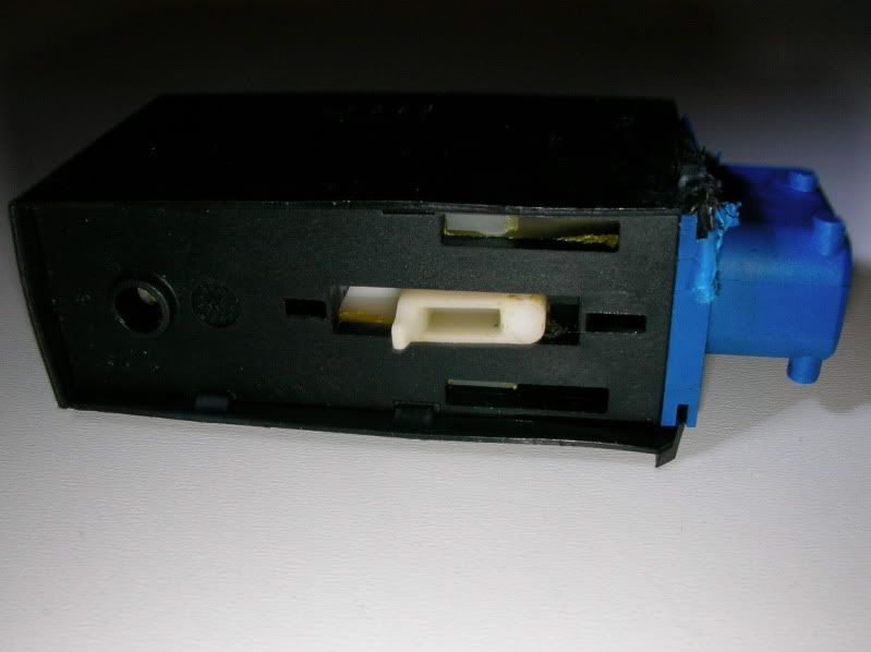

I took some fotos for anyone else who may come across this problem later. Fotos show the passenger side rear door with holes I drilled with a hole cutter bit. There are pics of the actuator, one showing the underside where the metal vertical lock lever goes into which the actuator moves back and forth to lock/unlock the door. On the side of the actuator case, you can see a wedged indent, it is the same on the other side too. These indents are what lock into the mounting bracket at the top of the door which hold the actuator in place ON the lock lever. You MUST take out the 3 torx bolts which hold the door latch in situ, which then may or may not drop loose, if not, give a little tap, then, and only then, can you pull or prise the actuator out of the mounting bracket. I also tried to take a couple of pics of up inside the door to show whats inside/where things are located etc. Hope these pics help.
