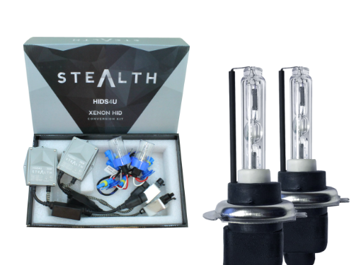

Is this the correct sort of thing?
Looks overkill, didn’t expect the extra cabling or have I looked at the wrong thing :LOL:

Well.... When I did mine I just got a different (but LED) bulb, plugged it in and it was canbus compliant and... worked :)
It was a while ago, and was on a 7 series, only cost £36, two and half, maybe 3 years later one side died, and ordered the same thing again, there have been people having problems blowing the central light control module with high wattage LED kits - couldn't see what those were on this one, also couldn't see how much they were, some are silly money for an Angel Eye upgrade...
The H7 HID conversion kit is for your headlight dip, if you have xenon not needed, it's mainly saying it's better than an earlier kit they did, did see it's HIDS4U though :) (also noted not suitable for use in a reflector headlight)
If you don't have xenons but poor headlights - halogens, several on here have used H7 LED replacement bulbs, advantage there is the halogen light source point is very closely matched by the H7 LEDs.
HIDS4U look like they've got out of the BMW Angel Eye upgrade market.
One of the highest value things you can do, it take the dead one out, then at least when looking at a LED replacement you stand a chance of getting the right replacement, the ledperf one may well be good for you, you could always talk to someone at ledperf, or email them, on the face of it, it does seem slight overkill, mine were ballasted, canbus compliant, all built into the bulb, and this was ages ago, could do it then, no reason why not now!
