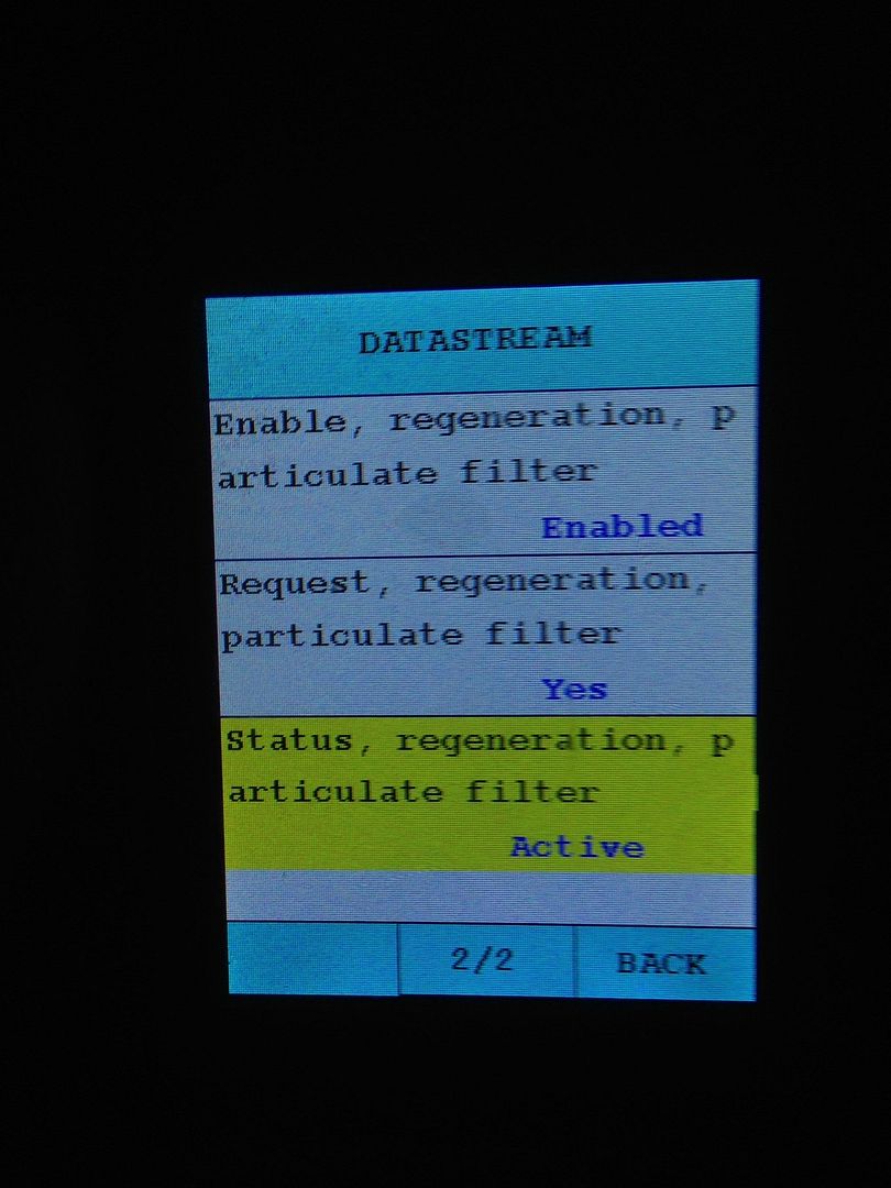

Hi guys!
Just thought I'd update this.
Yesterday I had a successful regen done on the M69 as verified via a C110 BMW scanner. The exhaust temp climbed up to around 580-600 ish degrees if I remember correctly and then the 'DPF status' on the scanner read 'active'.
The car was driving as if it were in 'S' mode at 65MPH and the revs were around 2300-2500. This lasted approx 15-20 mins.
Once I had reached my destination, I had a quick look at the exhaust tips and there was some white/grey ash substance. I cannot recommend the BMW C110 scanner highly for all Diesel engines for monitorin the engine temps and dpf status.
The only thing I noticed is that, the car didn't regen on the way back home whilst using the same driving style. I'm only guessing as it didn't require a 'regen' and was up to date in that department.
Now this morning, driving to work, I realised the engine felt slightly more relaxed and the mpg was slightly better. I think the DPF have an effect on the running of the vehicle if not regenerated for a prolonged period.
Hope this post helps

#5 ·
From what I understand, glow plug errors will not enable the DPF to regenerate.

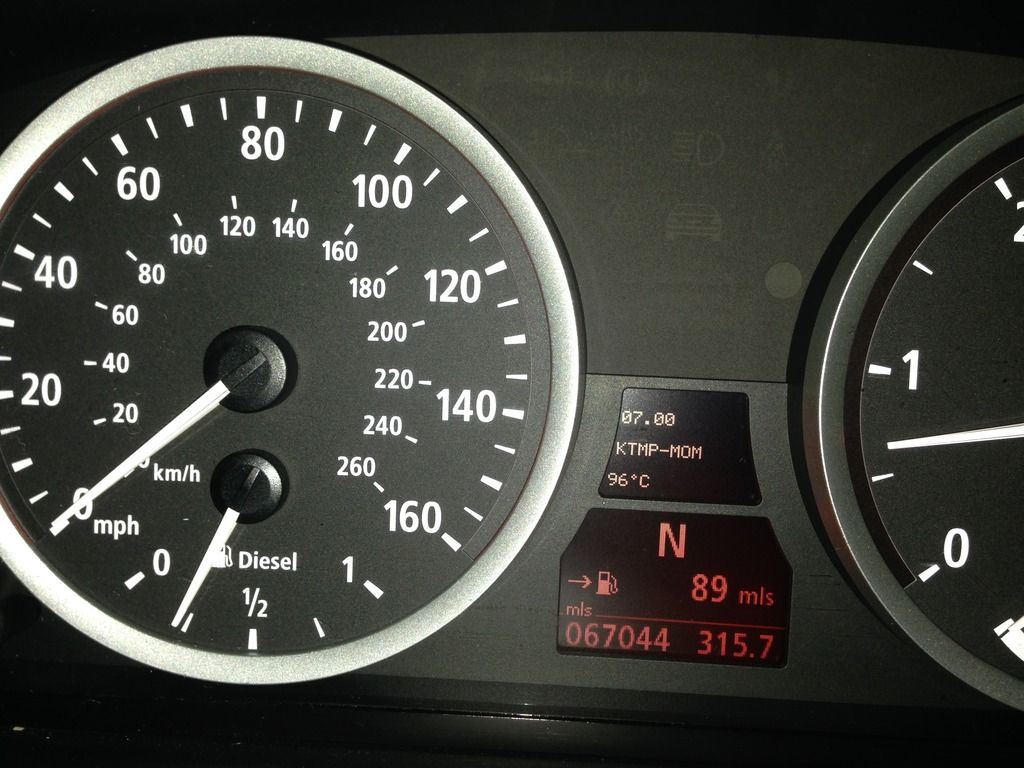

Firstly, get yourself familiar with the hidden menu to check your coolant temperature. Then get yourself a BMW C110 scanner (I bought mine for ÂŁ35 new) and check 'DME control unit' for any errors. Erase the errors if any present but make note of the errors stored incase if something needs attention.
Once you've started your car before your long drive, scan ecu for any faults and erase memory. About 10mins into your journey, your DPF should start the burning(cleaning) process. Ideally, you would need to keep the revs above 2000 rpm and do no more than 70mph. I would advise 60-65mph. If you've got the bmw scanner as mentioned above, it will show a visual indication that the DPF is regenerating. Regen typically lasts for 15-20 mins.
The main requirements are more than 15 litres of fuel, 75+ degrees Celsius of coolant temperature, engine revs above 2000 and no DPF or glow plug errors stored in the ecu, as whilst these being present, will not enable the DPF to regenerate.
Kind regards
PS hope this helps

#8 ·
I've not used the BMW app to which you are referring to, however the BMW C110 is like INPA/DIS in a handheld scanner. It is BMW specific and shows DPF temps/DPF regen status. It is a very in depth tool compared to the generic obd tools on the market which are useless as they only work when a 'check engine' light is illuminated.
Kind regards

Hi guys just a quick one..
Driving home now, realised my car was taking longer to change gears (2000+ rpm), so whipped out my C110 and noticed that the exhaust temps were around 600ish and it was showing an DPF status active. I thought a DPF only regens over 60mph and on the motorway?
