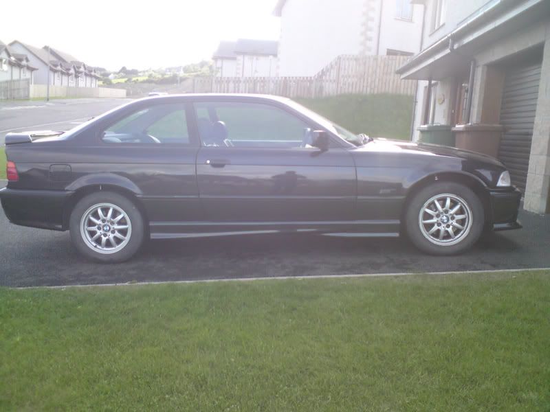

here it is before work started the rear had been lowered before i bought it -60mm i think and standard suspension on the front, it looked pish
here it is with the front suspension done and lowered as much as they would go, it was still the standard rears with the lowering springs
then due to the front springs taking lumps out of my alloys they had to get raised to 4x4 esque comedy suspension (i should have my other wheels back soon so i will be able to lower it properly then)
the car was raised high enough so the spring platforms would clear the tyres on the front. even with the helper spring totally compressed there is only a balls hair of space between the front tyres and the spring platform

what suspension coilovers/springs are you using and what width/et wheels are they taking chucks out of?
im looking to lower at some point and dont want any contact between the wheel and suspension, ill probably be running 235/45 17s (7j et35) on hot-tuning coilovers. (unless someone says its not a good mix of tyre and alloy)

its the hottuning coilies im using and the wheels are 7"x15" style 27's (et 47) with 205/60 profile tyres, ive had to raise the front suspension as high as it would go so the spring plates would clear the tyres and even then there is only a ball hair of space :jaw-dropping.

et47 will run close to the shock, any chance of posting a pic of the coilovers fitted if you put steering on full lock, as on the advert for them it is a generic pic and not of the actual shocks
cheers

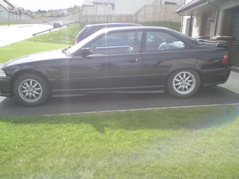

neither can i but i cant wait that long so i bought another set of wheels in the form of a set of 328 sport flavour style 5s (thanks plumb :thumbsup) that have just been picked up today so i should have them in a couple of days just to throw on the now so i can lower it

ive edited the thread
here is a better pic
these wheels are just to tide me over just now the coilovers are on their lowest setting so there is a ball hairs amount of space between the front tyres and the springs
