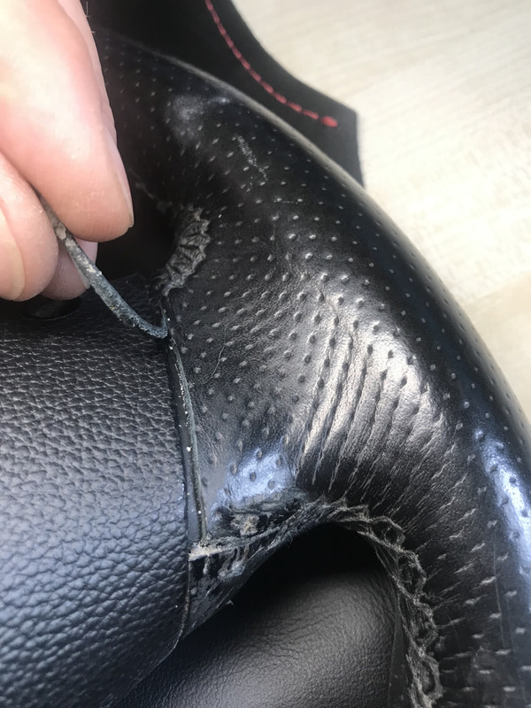

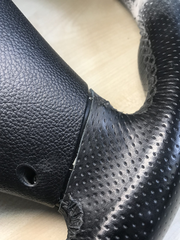

Here's the reason the wheel was replaced
And the stitching starting to fray where my thumb sits most of the time

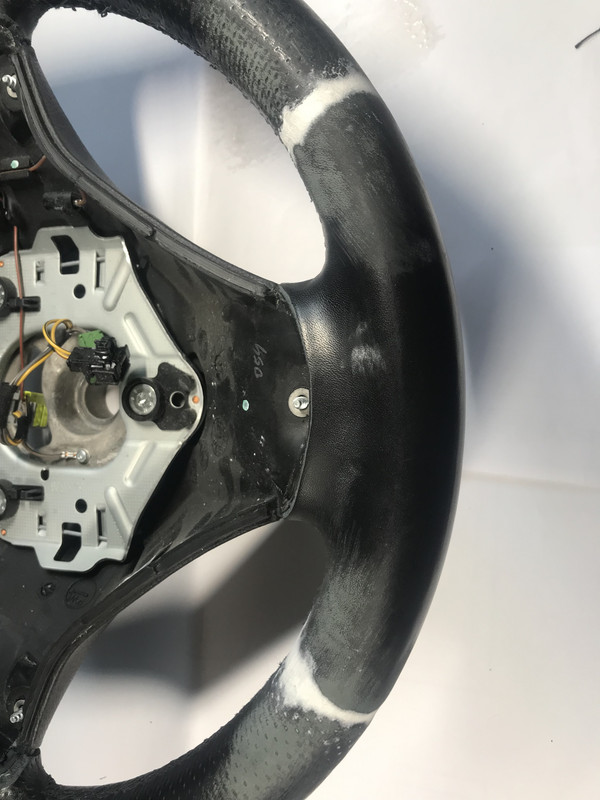

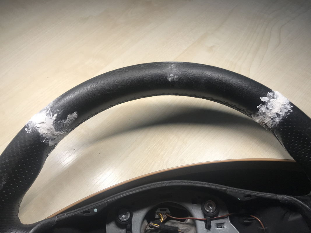

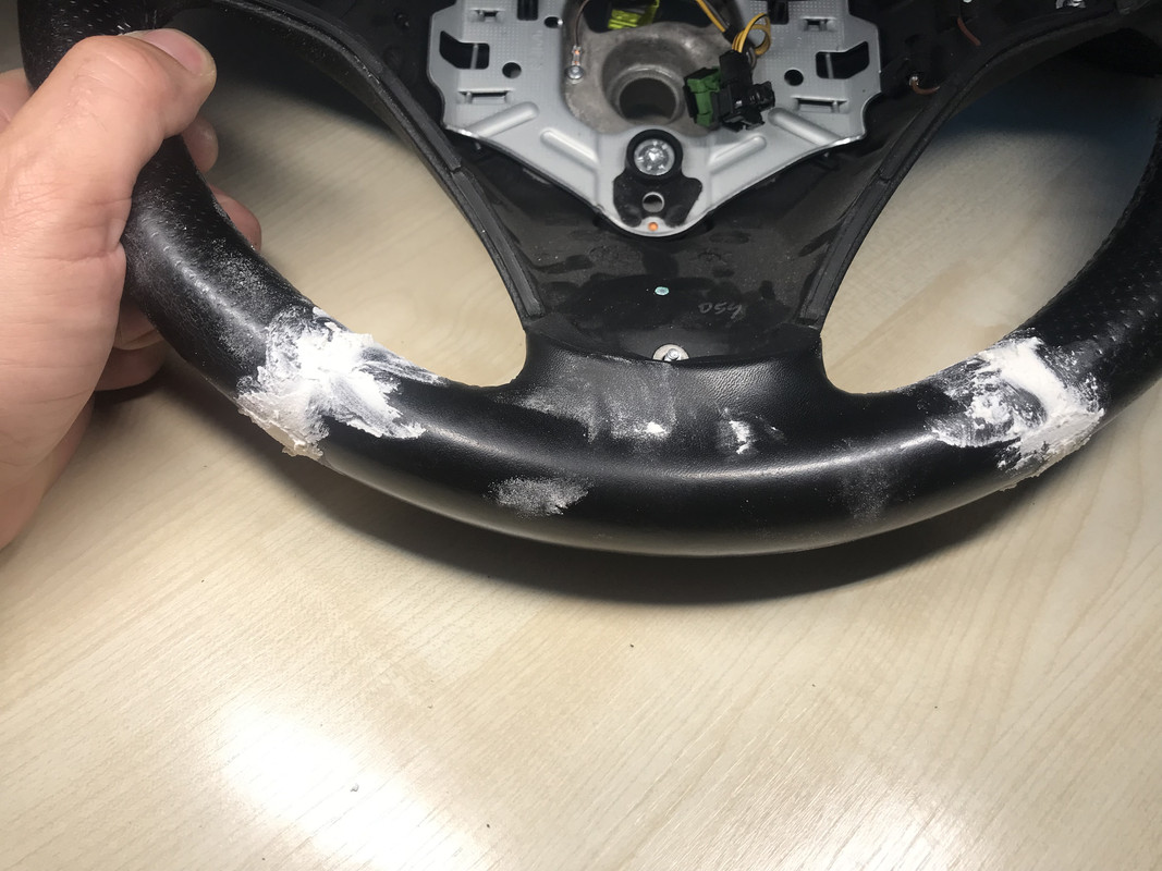

As with most things, I figured the quality of the final finish was going to be in the prep and after seeing videos and pictures on line it was obvious the joint in the leather falls in a different place with the kit and the original leather and leaves a divot in the finished cover so 1st job was fill the divot
and sand it flush

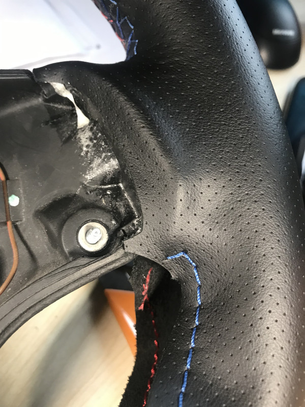

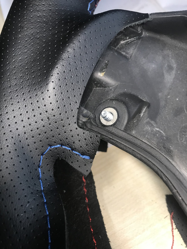

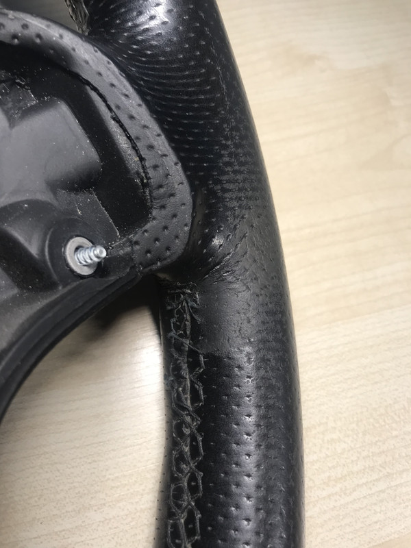

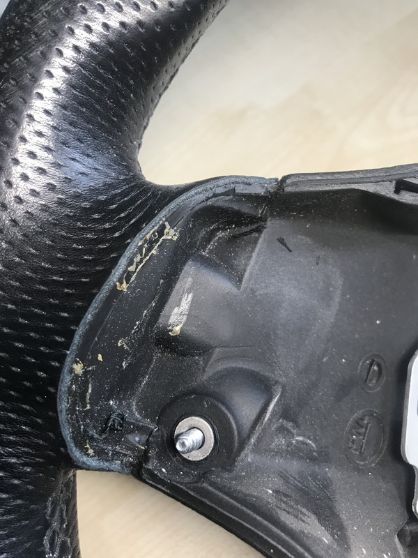

I didn't want the double thickness of leather to look bulky and hold the centre trim proud when it is replaced so I trimmed back the original leather at the 3 spokes
And to give myself a groove to tuck the leather into on the rear of the spokes I trimmed the OG leather back a couple of mm

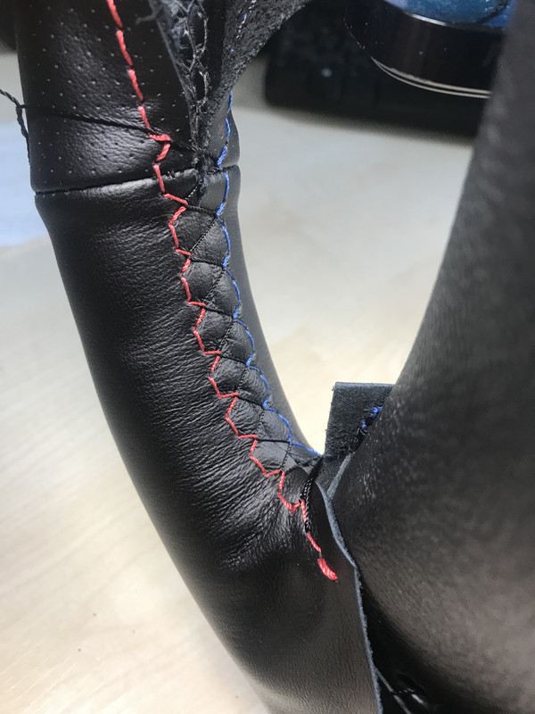

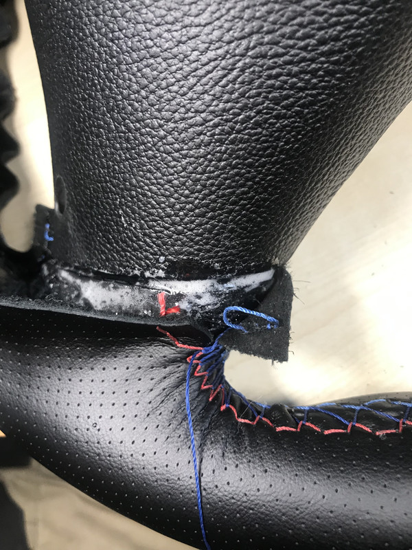

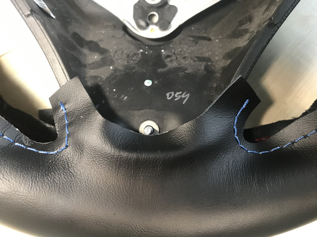

When I got to the spokes I held the leather tight and judged how much would need trimming off to sit right on the curve. I then set about unpicking the extra stiches and tying off the treads to prevent them pulling out
Here is as it came
and here is the opposite side trimmed to fit
Here the stitches unpicked, tied off and the leather cut back ready to stitch up and spray glued ready to tuck the edges in...
This was the most fiddly part but patients is definitely a virtue (I was concentrating on the job in hand and should have taken more pics)
Some sore fingers and thumbs later here is the results...

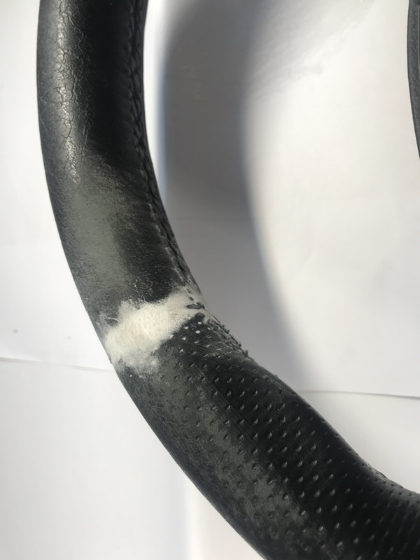

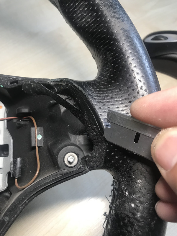

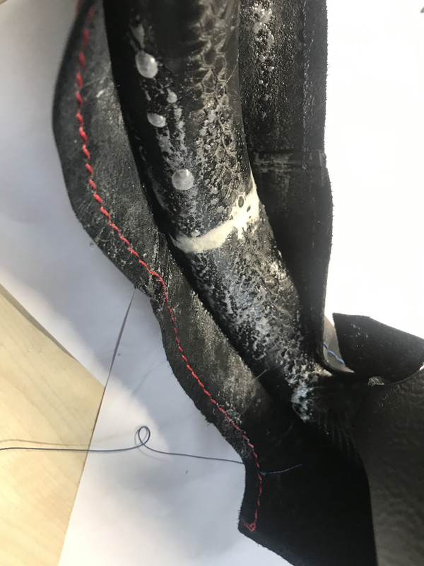

Once I was happy with my start point I then binned the double sided tape that comes with the kit and opted for spray contact adhesive as I thought this would provide better opportunity to adjust and rework the stretching and position of the cover as I went

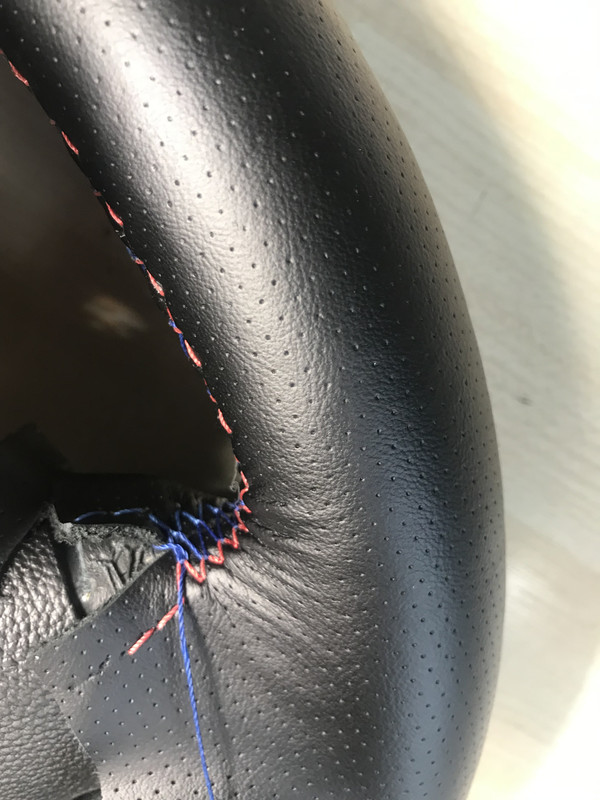

Here is as it came
