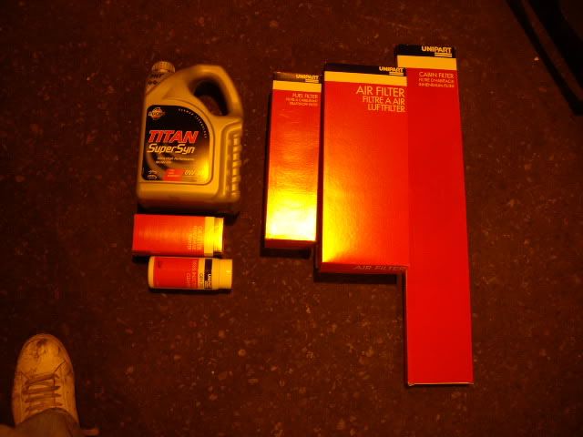

OK, less of the seriousness, lets get down to the service. Here are the parts:
there is only 4 litres of oil in the picture ( i purchased 2 more after i spoke to BMW parts).

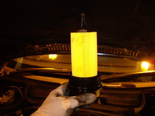

2. Changing the oil filter: On the top right of the engine you will be able to see the oil filter cap next the the dip stick (you may need to take the engine cover off to get to it, see step 4):
You will need a 36mm socket to unscrew the oil filter cap off:

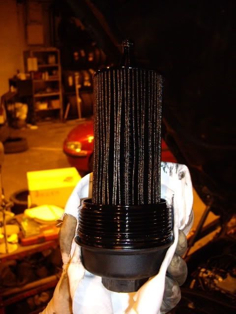

Be careful while using a little pressure as it is only plastic. Once unscrewed, pull it out slowly whilst you let the oil drain off the old filter. When it has drained, pull it out and put something under it so you dont get oil all over the place. It should look like this:
Pull the old filter off an take the rubber seal off that is on the cap. Put the new seal on and push the new filter on making sure it is on properly:
Screw the cap with the new filter back in to the engine and screw the oil pan plug/bolt back in tightly but not too tight and pour the 5.5 litres of oil in.
That is your oil and filter change.

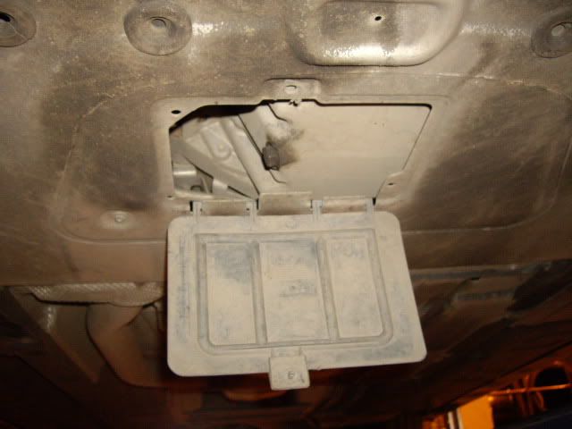

3. Fuel Filter: On the passenger side of the floor pan of the car (mine is a Compact, should be the same on the Coupe, Saloon and Estate) you will see a long metal cover:
There are 6 10 or 11mm bolts holding the panel in place. Start to unscrew the bolts nearest to the rear of the car and work your way forward and try to keep the panel held up as may drop and bend. As you come to taking the panel off, be careful as the side nearest to the side sill will have 3 washers in-between the panel and floor pan. When you have done that, it should look like this:
Using a 7 or 8mm socket, unscrew the jubilee clips at either side of the filter until they are completely loose. Use a small flathead screwdriver and lightly prise the pipe away from on side of the filter. Again, have something to catch the excess as there will be abit. When you have got the pipe off, plug the new filter in, making sure you have plugged the right side in and facing the right way up. Do the same to the other side and and plug the other side of the new filter in. Put the jubilee clips back in place and tighten carefully. And it should look like this:
Now place the panel back in place making sure you have placed the end lip back into the engine panel protector. Screw the bolts back in with the 3 washers on the side closest to the side sill.

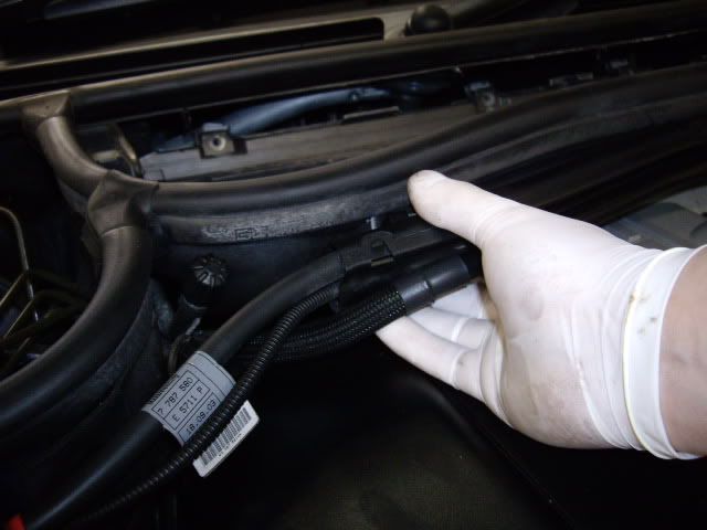

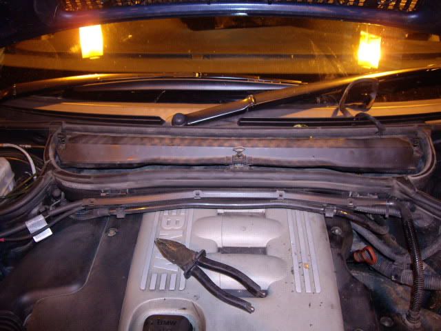

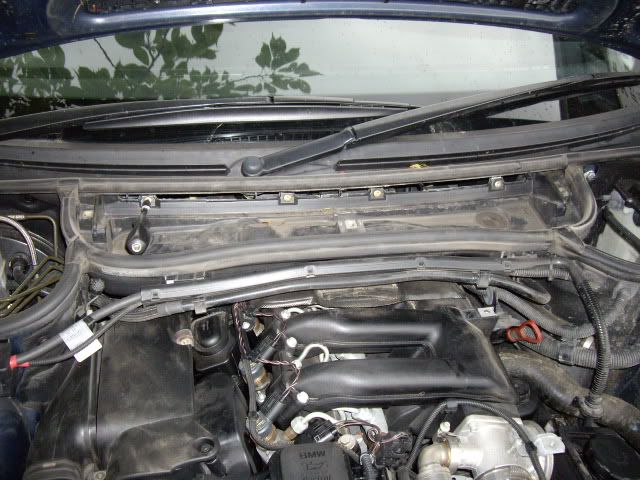

You will need to take the pollen filter out first, which is located infront of the windscreen:

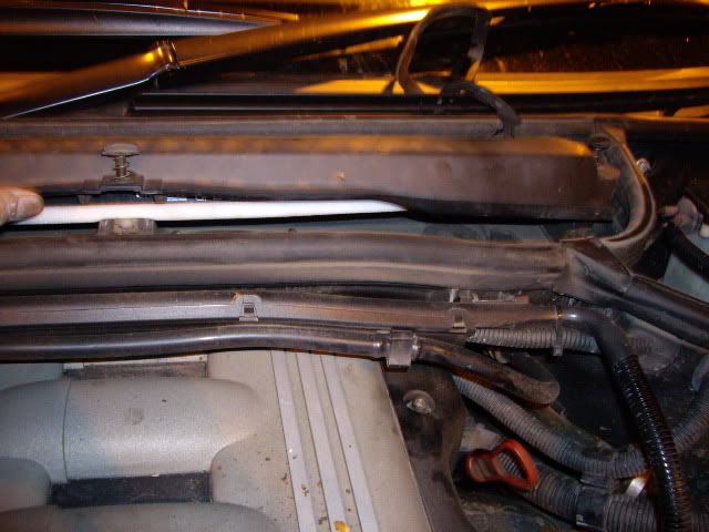

There are three clips, one on each side and one on the front, turn them and they should pop up and they have springs supporting them. Lift the panel up:

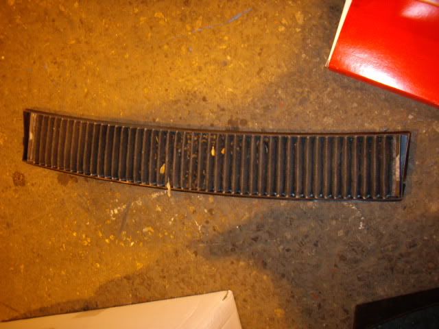

You will need to take the panel out, so be careful and pull from one side and it will come out. Once out, take the old filter out:

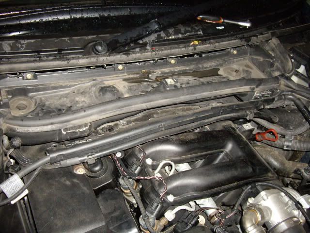

where the filter was, you will see 4 T30 (Torx30) screws holding another panel in place:

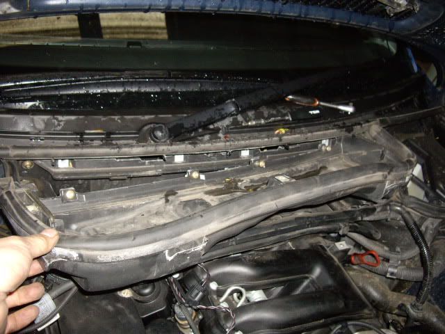

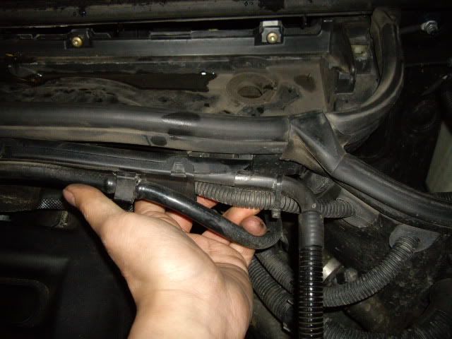

Unscrew the screws, they should stay within the panel once they have been unscrewed. Dont pull the panel out yet as you will need to un-clip the pipes running across the front of the panel. Put you finger under the cilp and put abit of leverage and pull away from the panel slightly and it should uncilp:
Once you have done that, you can now take the panel out. Lift the panel first and pull from one side:

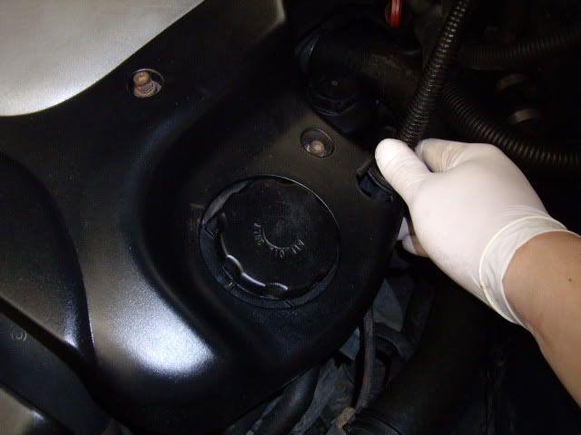

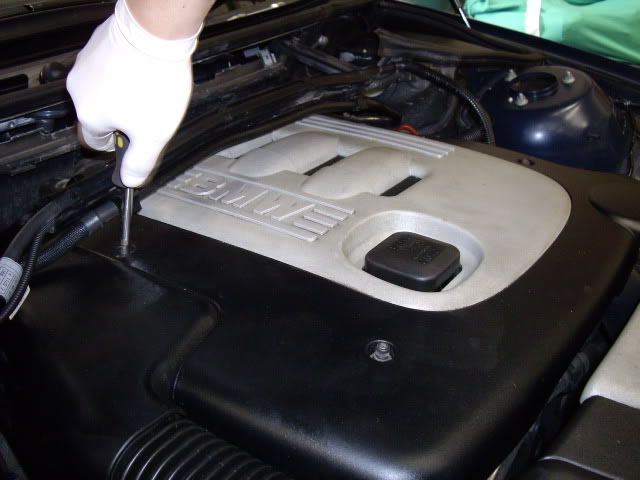

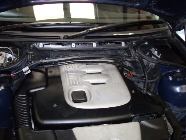

You no need to take the engine cover off. There are 5 bolts holding the cover on. 2 at the front, 2 at the back and one on the right side near the coolant cap.:

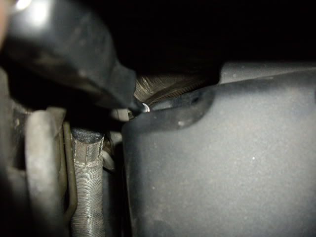

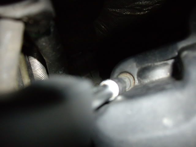

Push the rubber gromet off and you will now be able to take the cover off. On the left side of the engine you will see the inlet pipe and the air filter cover. The inlet pipe is held on by one bolt and the air filter cover is held by 4 bolts:
In the picture, you can see i have undone the pipe bolt and you can see first 3 air filter cover bolts. Unscrew them all and get ready to unscrew to last one which is around the rear of the cover:

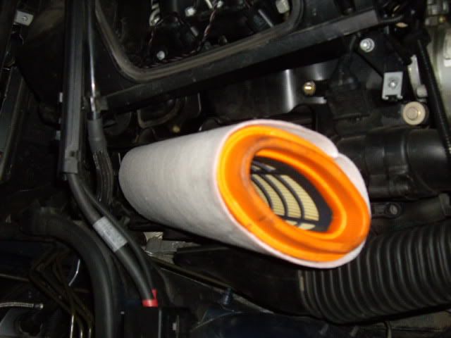

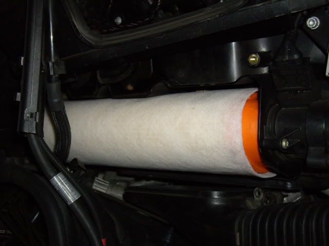

Once you have got it unscrewed, you will be able to lift the cover off and slide it under the pipes running across the engine:

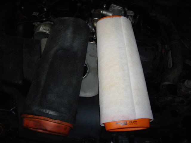

Pull the filter out, pulling from the end closest to the windscreen.
Put the new filter in, doing the reversal of the removal and make sure the dimple at the end closest to the winscreen is facing downwards. Make sure you have pushed the filter on properly and it is in a snug fit:
Pull the cover back over and clip back in place. It took me a while to get the panel right as there is a clip on the under side of the panel which has to clip in before you can screw it back into place. Once you have done that, reverse the instructions to get the car back as it was.

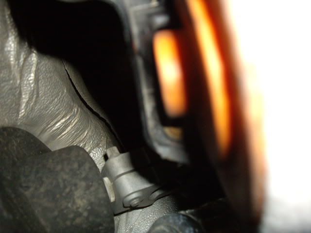

Another thing I noticed when I replaced the fuel filter the outgoing rubber pipe that heads to wards the engine has started to crack, its not split completely yet but I think it will need replacing soon. Does anyone know if this is an easy job to do? I think its item 2 on the following link:
http://www.realoem.com/bmw/showparts.do?model=AP72&mospid=47665&btnr=16_0512&hg=16&fg=15
Thanks!
