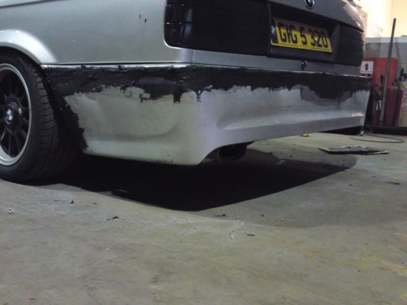

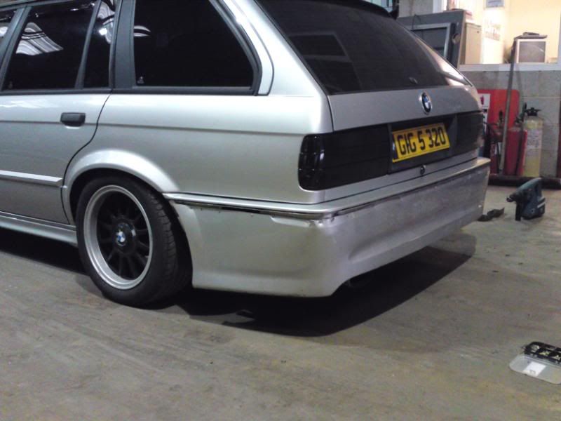

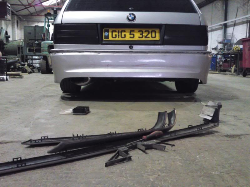

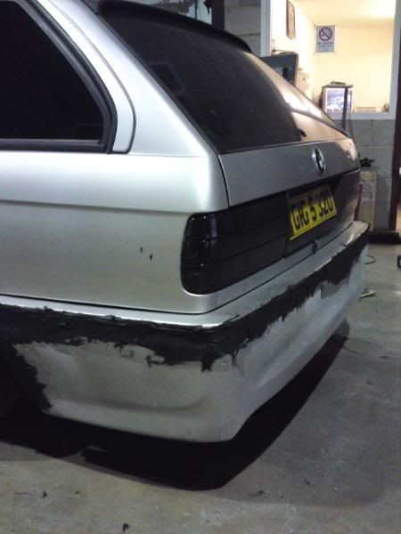

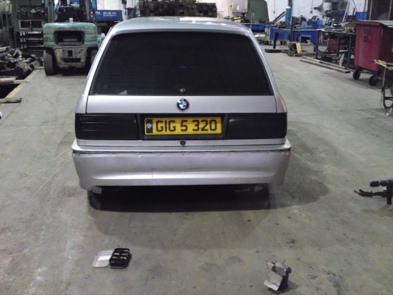

hi guys i have not found a rear bumper that i like for my car, so after a vision i decided to make one, i looked around and decided i liked the vectra rear bumper it had the lines i wanted, so i started it yesterday by cutting the top half from the bumper and removing the centre mouldings on my original bumper, then centralising the bumper and screwing and glueing with windscreen adhesive, 2 hours later after drying to touch i then mixed up some special black plastic filler which is flexible when dry and stared to fill the gaps, this is as far as i got as time was pressing on and i was taking the mrs out for her birthday, so next week there will be lots of rubbing down and refilling and rubbing till i get the right finish then i will paint it to its final result iv taken a few pics to show you what i mean what do you think ?
