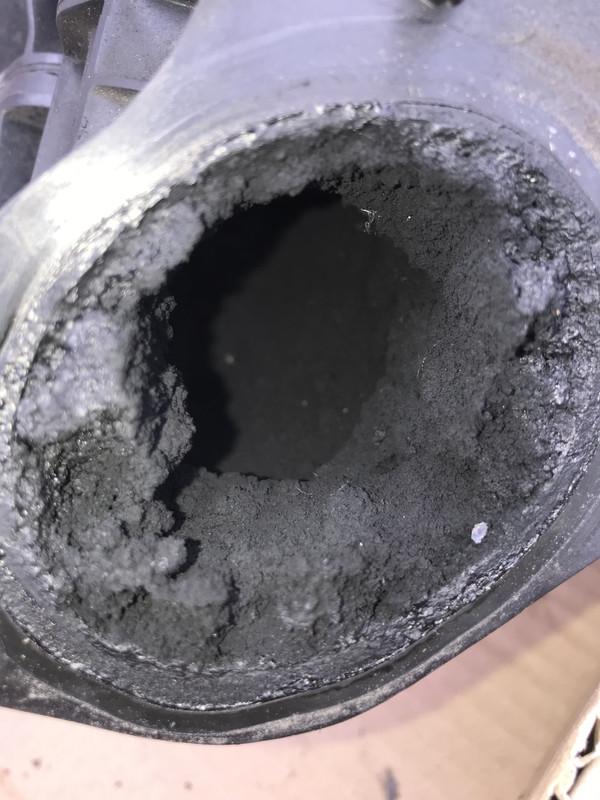

Hi there,
Took my 2013 640d in to my local indy today after noticing several problems like poor acceleration.
I have been told the intake manifold is heavily carboned up due to some kind of lever becoming jammed on. I have been quoted £1500 for a replacement manifold and walnut blast. I am guessing a good chunk of this cost is from an OEM BMW manifold, yet I have seen brand new third party N57 inlet manifolds for sale at about £200 (darkside developments).
Can anyone vouch for Darkside, or any other advice would be greatly appreciated.
Cheers, B

So a little update. I got my car back today and they have done a walnut blast to clean it out.
However, I have been told that the swirl flap motor could be jammed, so it might not be just the manifold that needs replacing.
I've seen a used N57 inlet manifold with the motor included. Thoughts?
