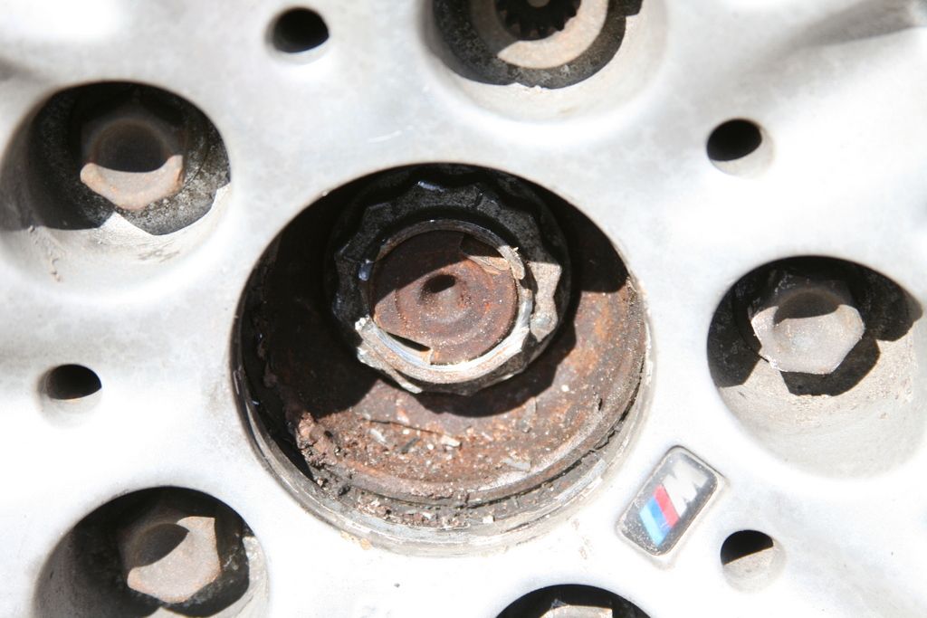

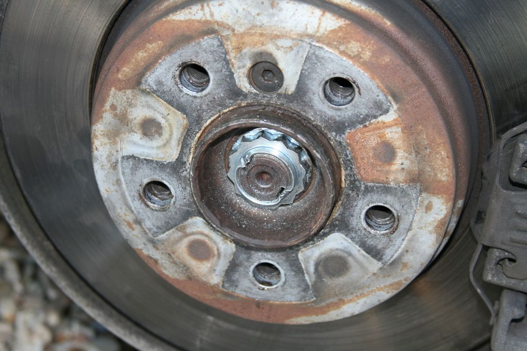

Firstly you need to loosen the 36mm nut that holds the half shaft to the drive flange

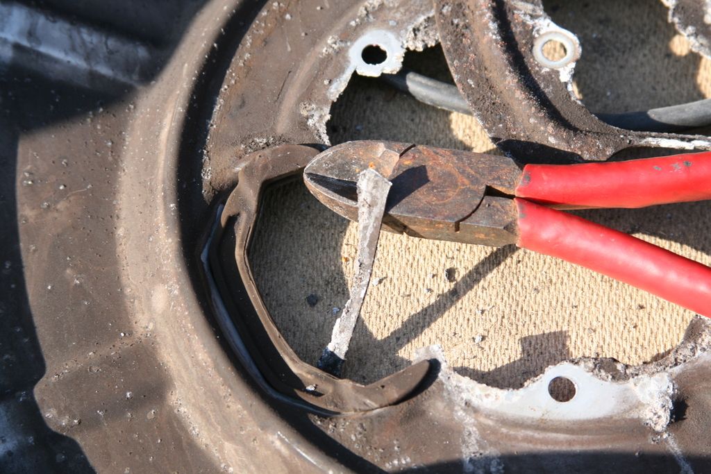

First break the tabs that lock it off with a chisel

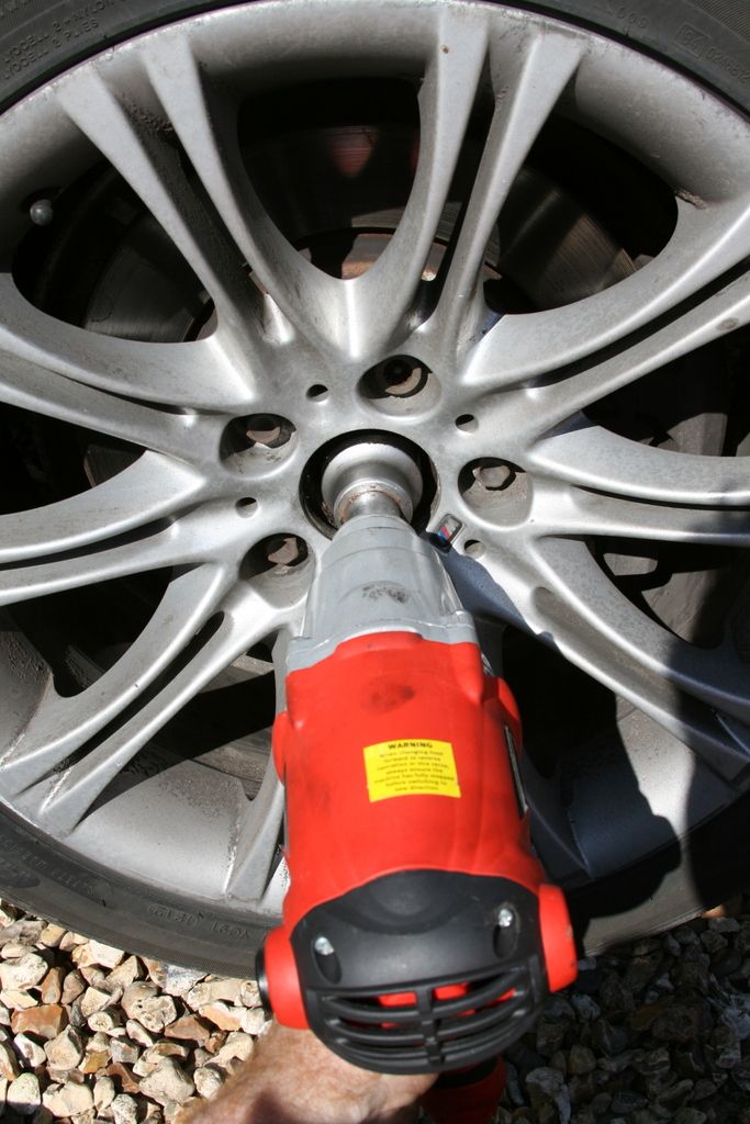

Then I used an impact driver to undo the nut but a break bar would sort it

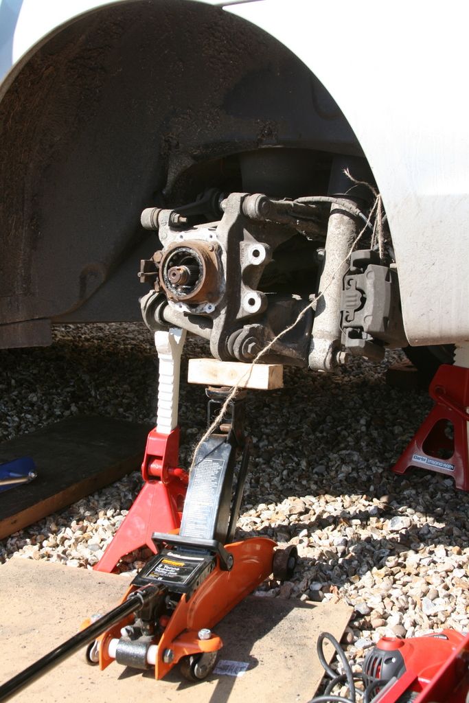

Remove the 36mm nut and jack the hub assembly up until the half shaft is perpendicular to the diff and hub. There is a reason for this, the proper way to remove the drive flange from the wheel bearing is using a press but you will find it near impossible to undo the bolts that hold the wheel bearing on to the hub with the drive flange on the half shaft. To the pull the drive flange off the bearing you can force it against the half shaft but it has got to better to do it when the half shaft is level to avoid damage to the CV joints. This is not the BMW way but it didn’t seem to do any damage. Note the jacking up is temporary, I would never work under the suspension unless it had back up support

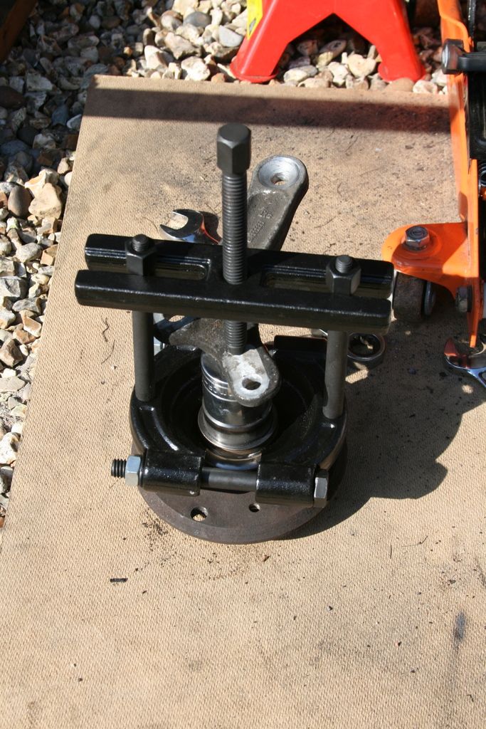

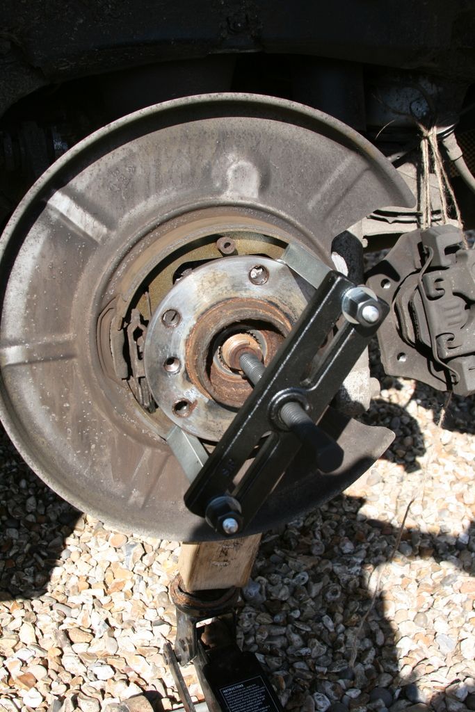

Now attach the puller from the puller set

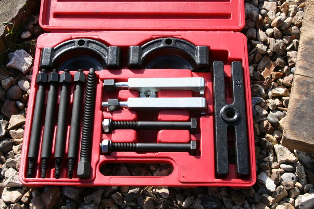

A bog standard puller won’t do it, you need a heavy duty one of these, it is attached at follows

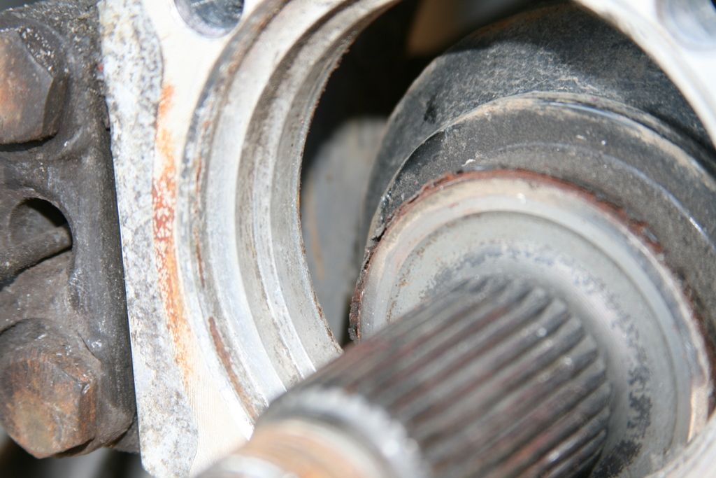

Wind up the puller and it will pull both the drive flange off the half shaft and split the bearing, note the golden ball bearings!

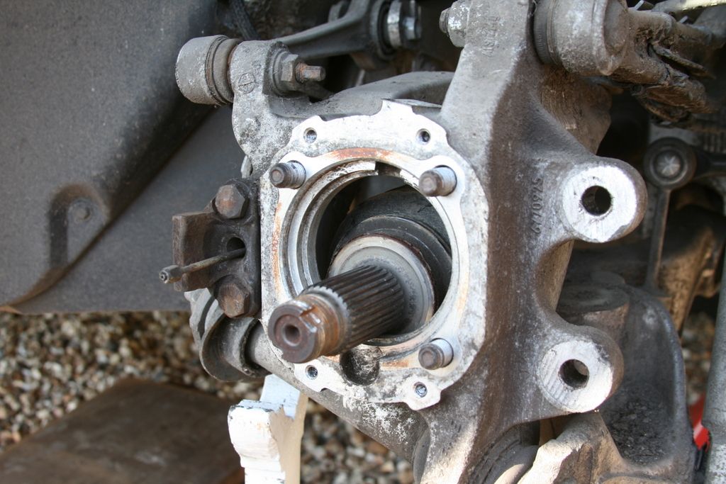

Next remove the handbrake assembly and dust cover, you don’t need to but it is a hell of a lot easy with them off, also remove and tie back the ABS sensor
Now jack up the hub assemble again until the half shaft is level and put back up protection in as you will be climbing under the hub to complete the job

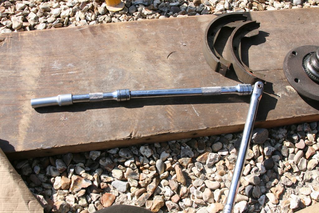

Now this may sound counter intuitive but I found that an E14 torx socket just slipped on the bolt heads as you need ubba torque to undo them (300nm) and so use an E16 as it stays on ( the bolts are 10.9 high tensile steel, so the E16 socket won’t damage the star). The reason I pulled the flange off first was because you can’t get a ½” E16 over the bolt unless the half shaft is free to move around.
You need a loads of extensions and a break bar
The bolts get really tight when they are half undone as the original Loctite clogs the thread up so spray the holes in release oil and wind the bolts back in and out again to coat in oil.

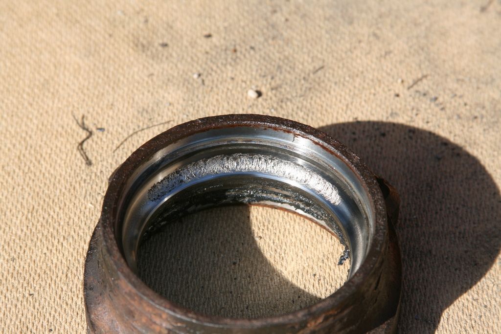

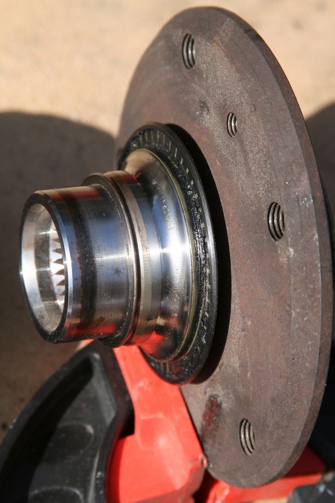

You can take the old bearing off now; this shows just how knackered it was, no wonder it was noisy

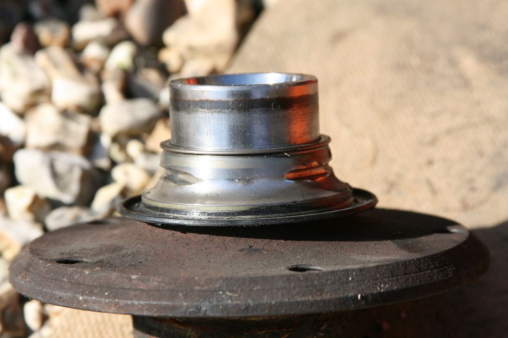

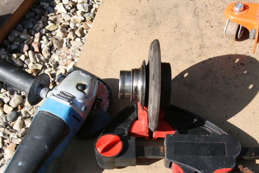

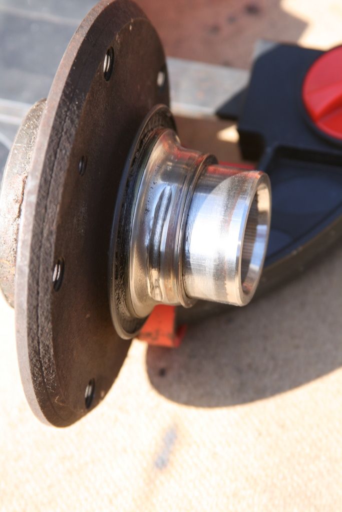

Now you have to get the other half of the inner bearing race off the drive flange, you need to clamp the flange (cursing myself for using my joinery clamps!!!)
See it was knackered to
Now using and angle grinder cut two slots in either side of the inner race
Now attach the bearing puller to these slots and pull the inner race off the drive flange

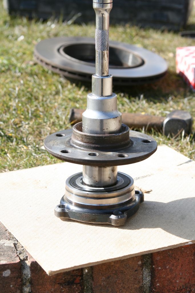

Next drive the drive flange on to the new bearing
Until it is tight up to the flange

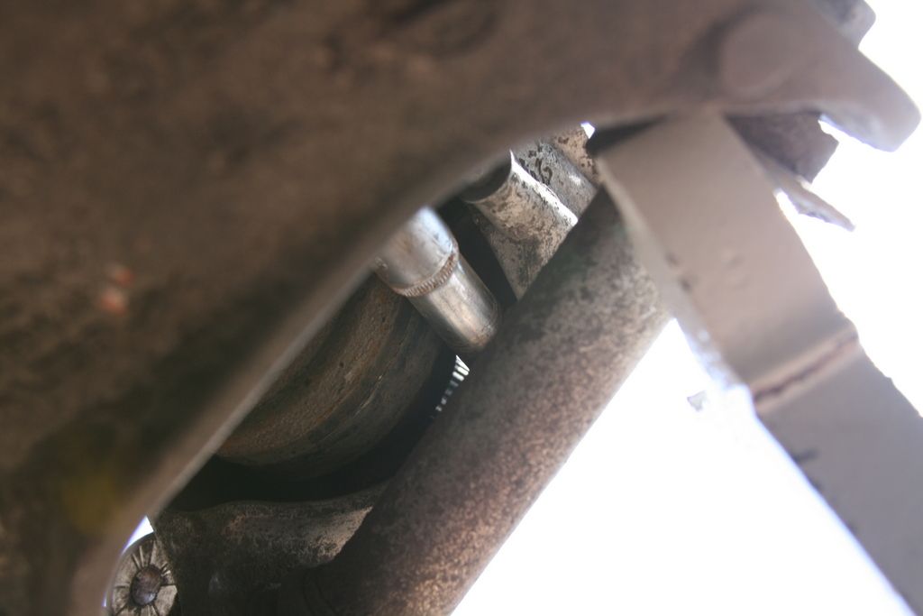

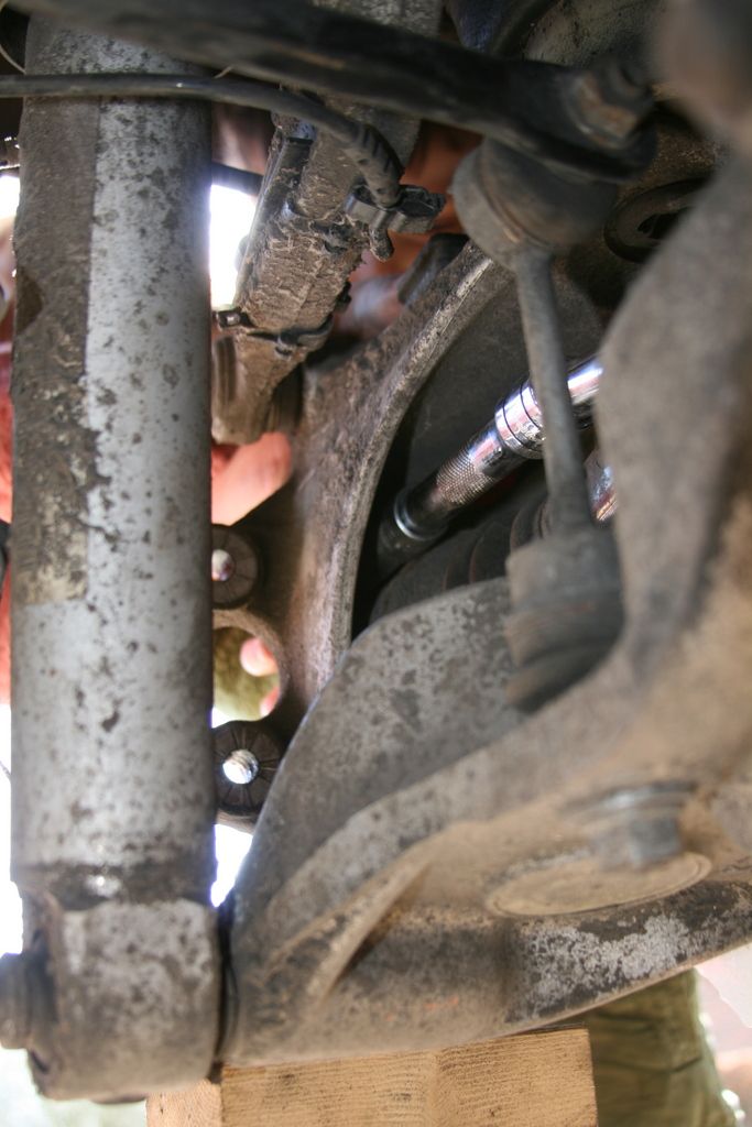

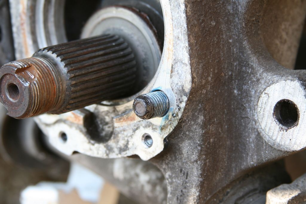

You will now understand the issue of get the new bolts in, with the drive flange and bearing off there is loads of space to move the half shaft, but with the bearing and flange in place it is very tight. You just have a small gap to get a 3/8” E14 small socket in
Next make sure all the bolts are in place with Loctite
See how you need the smaller socket to get behind the CV joint on the half shaft

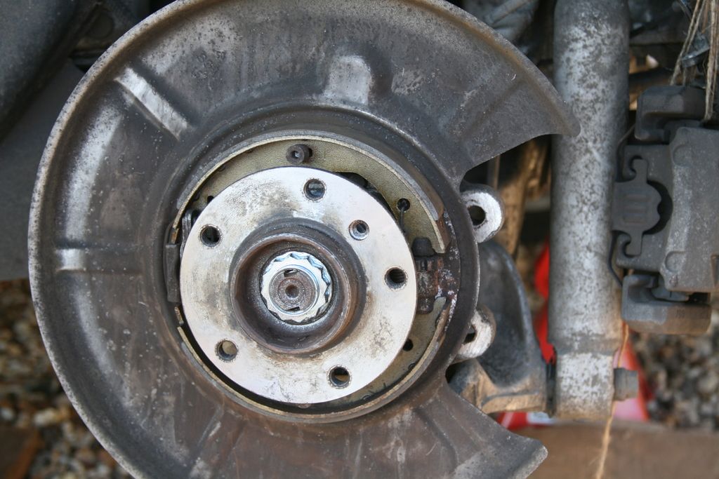

Now the smart one of you will have noticed that the dust cover and clamp will not go over the flange (which they won’t) but they so get in the way when you do are trying to bearing on so a little modification will help you 
And then fit them
And refit the handbrake assembly
Now put the wheel on and drop the car down on the wheels and do the 36mm nut back up, it needs to be torqued to 420nm and as nobody owns a ¾” torque wrench that goes up to 500nm I just battered it with the impact driver until it didn’t move anymore. It you have big break bar, just jump on it. Then pinch the thread locks on the nut
