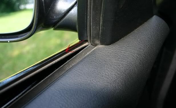

On to the door, i pulled back the rubber in the end of the door, but only a little, after some advice, and i stress gentley prise the end upwards while going down the strip with a flat blade screw driver, (which i rested on my credit card as not to scratch the paint!,) do not rush this job!!!!! or the trim will bend!.
When you get to the mirror part, it will pull towards you (more of a slide really) to release it from under the window. Once removed you will see that where you first started to lift the trim there is a notch that the trim will sit back in when refitting!
