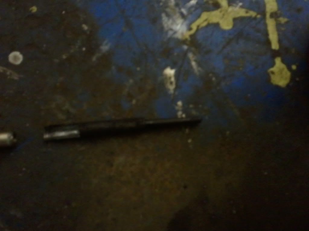

As some are I am sure aware, I have had an issue with a non BMW sludger that had a snapped glow plug....:frown

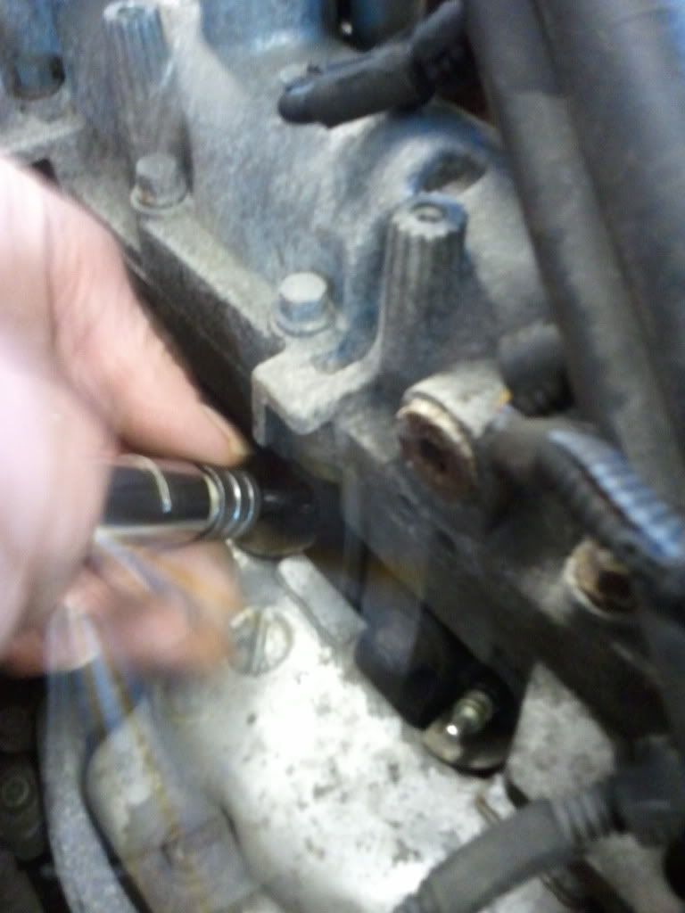

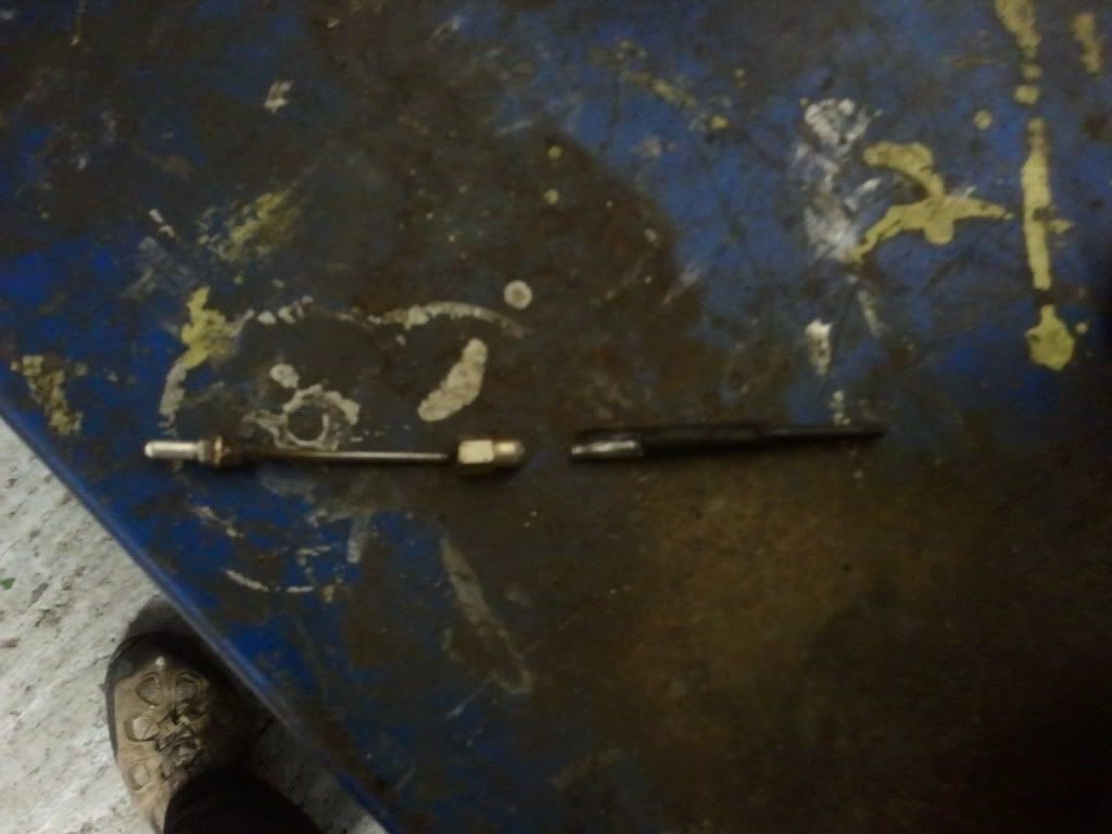

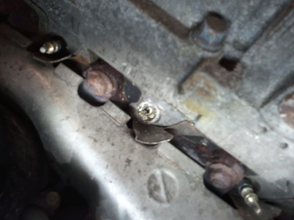

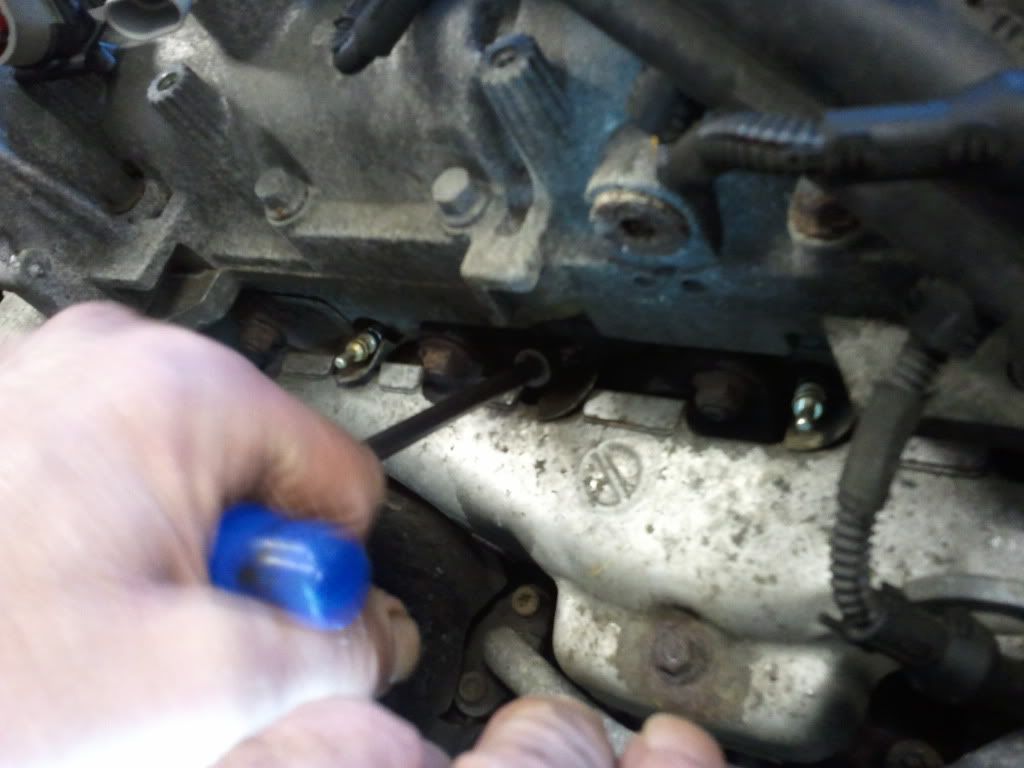

A 2004 Vauxhall Corsa 1.3 CDTI with a Fiat diesel engine in it, only covered 41k, anyway thanks to Simon and his help, today I managed to extract the offending glow plug without removing the cylinder head.:D
The reason that I decided to try and remove it without the cylinder head removal was simply cost. The machine shop only wanted £40 to remove the glowplug, but advised on facing the cylinder head (which requires the valves being removed on this model) £120. Then there was the cost of the head gasket set and new head bolts £100, the timing tool £50, a new timing chain, guides and gasket £150 plus the service items including oil and filter and new glow plugs.
The job also requires the sump to be removed and it's quoted at 7.5 hours labour:frown
Thanks to Simons help and tooling, it took me just over two hours to remove with the snapped glow plug with no damage to the head and required nothing more than new glow plugs and a service....:thumbsup
Thanks Simon, god I owe you one....:thumbsup
P.S. DD I still hate diesels....:hihi

It is very apparent that this glow plug had never been fitted correctly, the tip had not been seating correctly and was probably loose at the start of it's life, then coked up and corroded in place.

what tools did you use an easi out stud extractor or similar?
