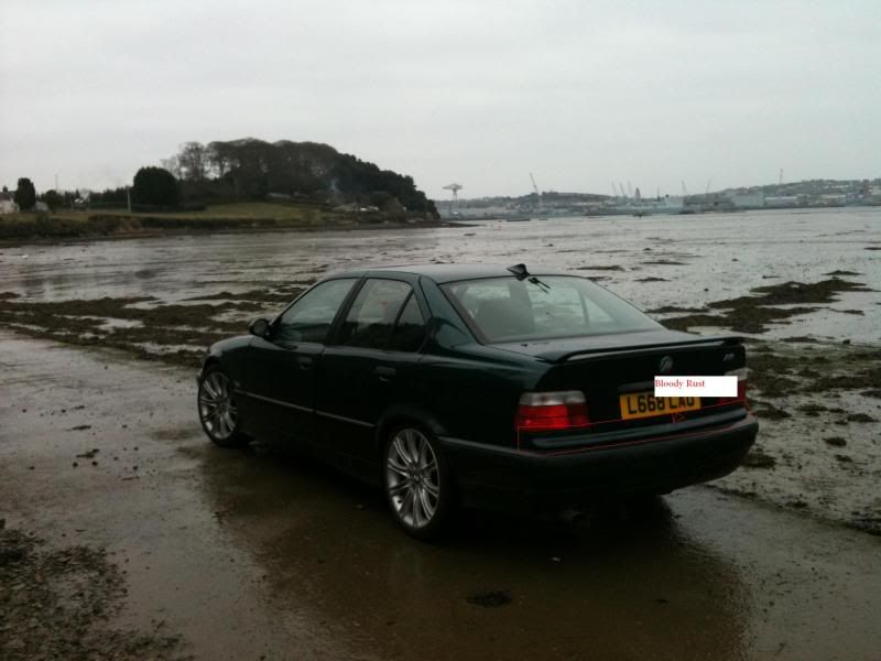

I have a rusy part and want to replace it here is a picture I have searched the RealOEM.com site cant find it!!!! please help
Sorry about the pic not the best!!!
Thanks

so number 2 on the pic there? great thats a cut out and weld in panel aint it!!! i had my fingers crossed for a replacment pannel for that section alone not the whole thing!!!!
might just cut it out treat it and glass it!!!!
thanks mate

With some basic metal shaping you could cut the rust out and weld a new bit in.
OR cut a good section from a scrap car and weld that in.

Nope it wont twist as Ive done this on a car before. Depending on how far along you need to cut its quite easy. The only difficult bit is under neath the light luster as you have to cut inside the boot and the light panel is double skinned.

Oh I wouldn't try and remove the whole panel, just cut the section under the bootlid between the lights, only replace a few inches worth. Unless your entire panel is rotten of course.

ok its just a section rite in the middle of about 3inch's but then the rust prob goes further under the paint!!!
